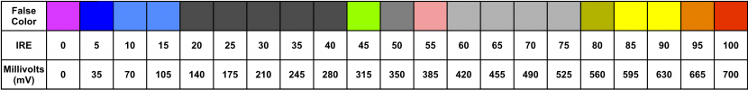

This is an absolutely wonderful plug-in. I took this plug-in and incorporated into a portable version of the most recent OBS. This portable version is preconfigured with preset scenes. Anything placed into the VIDEO SOURCE scene will be reflected in all other scenes for Vector/Waveform/False/Zebra
Used NDI Tools IRE Test Patterns 0-100 by increments of 5 to build out a scale for false color. Scale attached.
Download Link to ZIP file - Unzip and read the README to get started.
OBS-Studio-27.2.4 - Portable with Shading Profile
Readme
README - OBS-Studio-27.2.4 - Portable with Shading Profile.pdf
