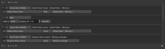

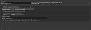

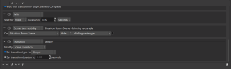

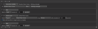

AccidentalGrenade
I am a poker streamer. I have used Advanced Scene Switcher to create a "Situation Room" scene which shows all of my poker tables. The idea is that I select a table, which is highlighted and then the scene will transition to my main scene showing only that chosen table. However, I'm finding that the scene keeps reverting back to the starting scene. Do you know why this might be occurring and if there is a fix or workaround?
Screenshots of Macro settings attached. Google Drive link to video of the issue https://drive.google.com/file/d/1V4S-CL9n33yicUYjbeTulJKXN8dcSxhM/view?usp=sharing
Thank you!

Warmuptill
Thank you!
Unfortunately, it is a bit difficult for me to understand what could potentially trigger scene changes in your setup as most of your screenshots only seem to show the action section of a given macro.
Or - just in case I misunderstood - do you only have one single macro?
Would you mind sharing your complete macro setup either by exporting the macros and sharing the import code, or preferably exporting all plugin settings to a file?
It might also help to have a OBS log file of the issue with verbose logging enabled (preferably with a timestamp of when the issue happened) to analyze the root cause for the unexpected scene switches.
AccidentalGrenade
The trigger is a hotkey - I play six poker tables, and use six hotkeys to switch between displaying each table. In the "Macro Settings 1" screenshot, the trigger for the scene swtich is me depressing the hotkey for Table 1.
I will work on exporting the plugin settings and/or macros here for you, as well as an OBS log file.

AccidentalGrenade
To answer your question, I have six different macros like this for each poker table (as well as other macros which are working fine). I only shared screenshots of one of the macros, as they are all exhibiting this behavior and I felt sharing them all could/would be redundant.
Warmuptill
I have a suspicion what might be causing problems.
At the end of your "Situation Room" macros, after performing the scene switch, you are modifying type of the currently active transition type and its duration.
Changing type or settings of the active transition while a transition is still ongoing can lead to those strange "canceled" transition effects.
Can you test if removing that last step in your macros resolves the issue?
I hope that helps! :)
If it does not I will try to have a deeper look tomorrow.
EDIT:
Hm .. after having another look I don't believe this is the root cause, as "wait until transition to target scene is complete" is checked.
It might still be worth testing if removing that step helps just to rule out that this is somehow causing the problem.
