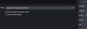

Enable this and then it finds zoom caption window
