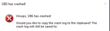

Hello To the Forum,
I am new and not very good in IT or programming things.
But I have an issue as well with the script of the mouse zoom and following.
I have installed python. It is on version 3.6.8
For that I did first: python -m pip install pynput
Worked well no errors.
Then I did: python -m pip install screeninfo
Work well too. No errors.
I downloaded the zip file from github and extracted it to my C: folder.
I opened OBS went to scripts. I added "mouse zoom and follow".
When I do that I get a message:
[zoom_and_follow_mouse.py] Source update
[zoom_and_follow_mouse.py] Source Name: Bildschirmaufnahme
[zoom_and_follow_mouse.py] Traceback (most recent call last):
[zoom_and_follow_mouse.py] File "C:/Program Files/obs-zoom-and-follow-master\zoom_and_follow_mouse.py", line 797, in script_save
[zoom_and_follow_mouse.py] hotkey_save_array = obs.obs_hotkey_save(zoom_id_tog)
[zoom_and_follow_mouse.py] TypeError: in method 'obs_hotkey_save', argument 1 of type 'obs_hotkey_id'
[zoom_and_follow_mouse.py] File "C:/Program Files/obs-zoom-and-follow-master\zoom_and_follow_mouse.py", line 770, in script_load
[zoom_and_follow_mouse.py] [source, source_type] = load_settings['source'].split("||")
[zoom_and_follow_mouse.py] KeyError: 'source'
[zoom_and_follow_mouse.py] Updating Source List
[zoom_and_follow_mouse.py] New source: True
[zoom_and_follow_mouse.py] Updating Monitor List
[zoom_and_follow_mouse.py] Monitor override list updated
To me it looks good so far.
But when I go to the settings and Hotkeys, I cannot find anything related to the script.
But instead I get an error message and now I don't know what to do:
If it helps, I work with OBS 27.2.4 (64-bit, windows)
When I close OBS it crashes and gives the error message enclosed in the png.
Does anyone knows what I can do to fix this?
Thank you so much for your help.

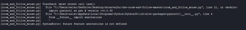

what can be the reason for the follow not working (just a quick zoom in to the top left)? The settings are correct. I installed Python 3.6 (portable version).
Thanks in advance.
I had the idea that probably the portable version of python could cause some issues, so I installed Python 3.6.8. regularly but now get the following:
