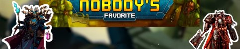

Does this only do flat and circular? I'm looking for an audio visualizer that will outline an avatar. See attached.
Yep, just flat or circular.
If you just want some indicator for audio activity, you could maybe take a look at the Scale To Sound plugin.
