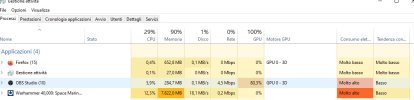

Very High Power usage while streming

OBS use 1.5 gb of ram, is that normal?
If you think people are getting more out of less, run a Cinebench2024 stress tests on your system & see if it performing the way it should. There's tests for both the CPU & GPU.
Yeah, it needs more RAM.
