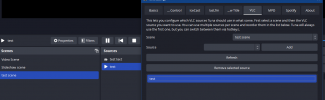

Hi im new to this Tool, its Very kool but Im trying to get the internal OBS VLC media source and Tuna to play nice. It seems to seems to edit the text file fine when the video in the source but when theres an audio file, I just get the Place holder text I set. I can not figure out why.
Ive edited the meta data, I've made sure the format was correct, Ive uninstalled and reinstalled, Ive closed OBS a few times. no dice.
Any help or advice? Did I find a bug or am I doing something wrong?
UPDATE: I closed OBS again, when I Opened it back up it was working the way I wanted.
