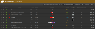

Step 2: Create a New Tampermonkey Script​
  1. Open Tampermonkey:
    • After installing Tampermonkey, click on its icon in the Firefox toolbar.
    • Select Create a new script.
      click on the + and a new Script will appaer

    • Step 3: Save and Activate the Script​
      1. Save the Script:
        • Once you've pasted the script, click on File > Save in the Tampermonkey editor.
