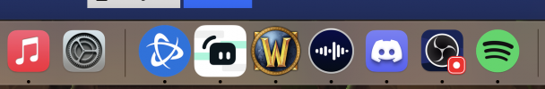

azaire1180
Hello, I would like to send you a bug:
When I launch several audio applications, obs bug on mac ARM (wave link + spotify+streamdeck )
It worked well on the old version, can you explain to me why?
The sound becomes very weird at times and necessarily I have to cut everything.
