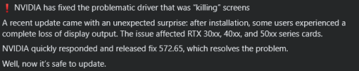

So as of recently Nvidia has been having a lot of driver related issues and I am part of a small PC community group and tech enthusiasts that find issues related to gaming or drivers in general so. Recently and now Nvidia released 570.65 whiched solved a lot of crashes and issues relating to crashes and even blackscreening during idle or loads.
Also here are some new things that OBS implemented since Enhanced Broadcasting took over and the older nvidia nvenc is now depreciated. which you can find on obs stream tab when you go to settings enable enhanced broadcasting.
I would repeat the DDU steps again on safe mode and download the Nvidia app to get the latest version which I am currently running using a RTX 3070ti 572.70. its stable and haven't had any issues.
