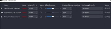

Hi AaronD, the Behringer has arrived, I connected the 57 and I'm using Obs with Windows now, the signal arrives because by touching the microphone I see the volume bar on Obs advancing, but when I start recording the audio is not captured, I'm definitely doing something wrong in the settings, can you help me?
Thank you
What's in your Advanced Audio Settings? And Settings -> Output and Settings -> Audio? (you should be able to predict that question)
HI! Here are the sound settings!
That's fine so far. That only gets you the mic input, which you already said you had. What about Advanced Audio Settings and Settings -> Output?
Hmm... You have the Monitor disabled (I think is what that says), which keeps the Output on. And you have the Output going to at least Track 1, which should be what the Simple recording mode picks up. That should work.
You won't have it in headphones though - that's what the Monitor is for, and you choose the Monitoring device on the Settings -> Audio page. According to your previous screenshots, you've left that as Default, or whatever the OS has selected.
You say it's not in the recording?
Also, if you want separate volume control of each input, you'll need to have two copies of that stereo source (two globals set to the same one), then in the mixer, right-click and Rename them to something that makes sense for each, then in the Advanced Audio Properties, pan them hard to either side and check the Mono box for both.
Now each one has a separate volume control, but you'll still want to experiment to see if the filters (EQ, Compressor, etc.) that you're going to use (if any) work sensibly. That is, do the filters on one signal only see that one signal because the Pan and Mono come first? Or do both sets of filters see both signals and respond to them because the Pan and Mono come last? You probably don't want the latter.
A DAW won't have that problem, but you then have to loopback or virtual audio cable the finished signal from there into OBS, to pass through unchanged. All of that is free too, after some googling.
I managed to get the audio, I did some tests, restarted Obs, but frankly I don't seem to have changed anything, I still hear the audio, but the volume is low, the volumes on the PC are at maximum, the input volume is set to maximum so as not to clip, to record the voice I would need the microphone to be 50 cm away, the 57 is probably not suitable for this, will it take a panoramic?
