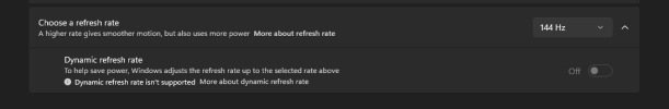

i sadly dont have a 120z option for my monitor, i looked in both nvidia control panel and the windows settings.. the only other option i have is 60hz
also which drive? the C:?

Hopefully things runs smooth @ 60, if not easier to troubleshoot. Once 60 is stable, we can try to figure out why the high refresh rates aren't doing so good
