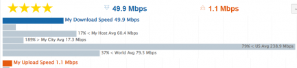

here is my upload speed per another site, which... god damn it. and my ISP has already pretty much told me to jump off a cliff :)

Yeah, I know that 1.1 is too "small". The issue at hand is that my practical upload speed is somehow 10x less than the speed I get via other testing, and my ISP is now essentially calling me a liar.
No, your ISP sell network speed from home to first bridge network, rest network and speed is 'is not under the control of the ISP'.
Some times is possible broken connection or your ISP buy too small network bandwidth.
The reality is that supporting your use case may be something your ISP does NOT care to take on. Have you checked your ISPs Terms of Service?
I'm the kind of person to get righteously indignant, and rub other folks the wrong way (and that will get in the way if trying to get your ISP to support a new use case). Ideally (wishful thinking?) you'd find someone at the ISP you could talk to in terms of understanding the network (ie, don't accuse, seek only to understand) and mutually go on a journey to understanding your network traffic experience. Doing so likely means you'll need to learn and talk accurately in network terminology.
Hopefully your exhaustive reading has pointed out that speed test (ex. Ookla) are HIGHLY optimistic. They drop outlier results... BUT, when streaming, it is the lower sustained threshold that actually matters.
A wireless ISP having bandwidth, latency, and jitter variance are to be expected (all of which are terrible for livestreaming which typically is looking for CBR). And any test you run at one moment won't necessarily have any bearing on expected upload throughput the next moment. but I assume you don't have much choice... so, my $0.02
- most ISP know that vast majority of bandwidth is consumed on the download to client, therefore the consumer networks are configured to support that traffic pattern. And much of the upload traffic is using patented compression algorithms (ie Zoom, Teams, FaceTime, etc). In the overall scheme of things, livestream users of H.264 (inefficient from a 2023 perspective) is on the rare side, meaning the network is NOT optimized for such. And then there is the whole challenge of network consistency with wireless traffic (an oxymoron).
With that as context
- for a more meaningful bandwidth test, try uploading a large file (maybe 1GB??) to a internet based storage location (OneDrive, iCloud, Google Drive, etc)...and monitor throughput (NOT transferring via browser, ideally). If throughput is consistent, and in the multi-mb/s range, that a good sign. Now, different p[rotocols, network QoS, etc, but a good start. Then again, if upload throughput is inconsistent, then you either need a better connection (antenna, modem, router, etc) or it is the ISP themselves (or simply more clients/traffic in your area than your ISP can support with your use case).
There are better tests, but this one most folks can do.
As Tomasz is alluding too.... the test I'm proposing is an end-to-end test. But your connection from home to ISP's antenna could be fine, and there is some constraint on their back-end (which may or may not be within ISP's control to some extent .. a small ISP may not be able to afford a better (more expensive) uplink). There are ways to test each step in the route. BUT there are caveats to what an end-user can test, and it quickly gets complicated.
- *IF* a file transfer, or other similar bandwidth test looks positive (ie never drops below 4kbps), then it may well be a network config on the ISP's part (or their upstream provider) impacting Twitch traffic.
