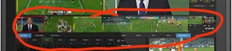

I want something more basic.
That's different than the OP's request. What you're looking for (input previews) as shown in your screen shot from Vimeo Livestream Studio 6, or from my attached screenshots below of vmix, wirestream, and tricaster/viz vectar, and is a feature I thought I recall one of the devs for OBS saying there is no plan to develop. While it's weird and not great that obs doesn't support this like most other software switchers, you can make something similar to it with the Source Dock plugin mentioned above, though it can be a bit cumbersome to get looking organized and clean with many inputs.
