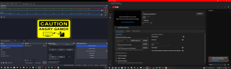

Why is it not streaming to twitch? (this is what i downloaded and this is what my obs looks like now) can anyone help me figure out why its not streaming to TWitch but it streams to youtube only!!
Same thing happened to me today, and I came here for some answers. I have Twitch as my "main stream" and YouTube as my second, but Youtube was the only one live. What gives?

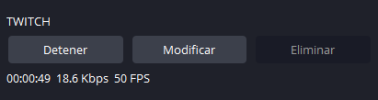

I'm having the exact issue, only half of my stream is on faceboo and Youtube. In OBS 30.1.2 it appears to be fibe both starting and stopping the broadcast. I do however go to "Start Streaming" then in the multioutput window "click" start all.
Any information or resolution to this issue would be appreciated.
