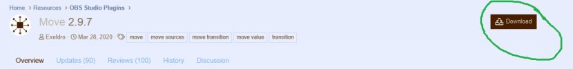

hey im a windows user and was having the same issue with the transitions not loading. It looks like this download link installs the Linux version not the Windows version.
When I tried this link at the top of the screen it worked just fine when I opened OBS.
Glad you caught that! Regretfully it didn't help me, as I downloaded the right version originally. (move-transition-installer.exe) Maybe I should just live without these fancy transitions. :-(
