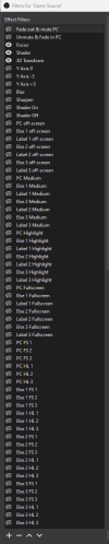

I love that you can now set zero duration.
I create dummy move filters to call multiple move filters so they happen simultaneously, but I had to set the minimum 10ms - I've changed them all to zero now!
I still think a Move Control filter would be a great addition where you can trigger more than 2 filters concurrently. It would mean fewer filters! lol
See attachment - the PC FS 1 filter downwards call the ones above it to shift various sources around the screen.
