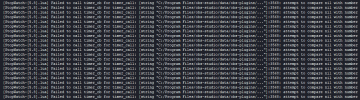

Hi.
Didn't test it yet, because i have an error. I use it this way for time since last goal. Hotkey on streamdeck on my goal button. First reset and then start (Reset goes to 00:00 but not restart it). It can run even if if the error shows.

Hello! I'm using version 5.8 and would like to save the time on the timer after exiting OBS. Using the "Autoload last time stamp when OBS starts" function, the time is saved, but after restarting the OBS and starting the timer, an error appears. I use win 11.
I'm having this issue sometimes.
Thank you, I will look into this.
