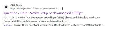

Using OBS "Lanczos" Downscale Filter:

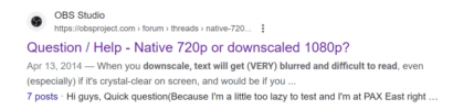

Using OBS "Area" Downscale Filter:
This one looks a little better than the Lanczos filter one, but some lines in the letters are rendered too thin (like the "E" in PAX East in the last line)

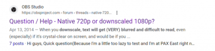

Using Nvidia ShadowPlay:
The output resolution is also downscaled to 1080p, but ShadowPlay gives a much much cleaner result

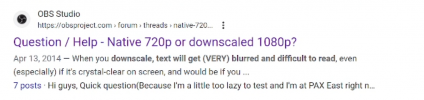

Using Windows 11's Xbox game bar:
Well, even the built-in recorder in Windows does a much better job than OBS...
