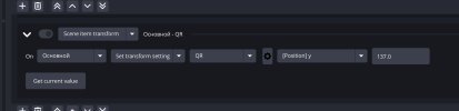

Rozenman
Dear Warmuptill,
If you have time, please see if it is possible to solve the problem of the program crashing when performing the operation shown in the screenshot. It is not critical for work, but I would like to fix it.
Thank you!

Warmuptill
Dear Warmuptill,
Thank you!
Thanks for reporting the crash!
A build with a fix will be available here in a few minutes:
Note that you have to be logged into GitHub to be able to download it.
Let me know if that should be an issue.

Dear Warmuptill,
For some reason I can't download the file - there is only text, and I can't find the link.
Warmuptill
Dear Warmuptill,
You will have to be logged into GitHub to be able to download the build.
Otherwise the option to download the build is not visible.
