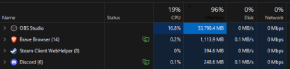

...my OBS makes my cpu go up to 20% use and most of all using 60go of my 64go of ram!!! I then have to wait before I can click anywhere in OBS for like 2 whole minutes... (not kidding, I timed it). I wonder what that macro (If media source) is messing up in my OBS.
That sounds like a bug to me! Massive memory leak at minimum. It doesn't do that for me, so I wonder what's different?
Turning OBS off and back on, or the whole PC off and back on does not change: I have to go to OBS safe mode and then delete my whole scene, groups and media sources (so much work wasted..) to be able to use OBS again. Any idea?!
So it's something about the configuration itself, not the action that you do with it. Are you inadvertently trying to run EVERYTHING at the same time? I thought OBS did already, just to be able to show immediately, whatever you decide on a whim to show, but this seems like something else!
Can you make a new, blank Profile and Scene Collection, and build that up to a minimal configuration that shows the problem? Or duplicate what you have so as not to mess it up, and then pare it down to that minimal example?

May have a bug? I have a group with 31 media sources, a script running so that only 1 source can be active/shown at a time. Attempting to work on the ducking again, so created a condition if media, any media source on groupname, soon as I selected that
group OBS went into hang mode... 99% cpu 99% memory (i have 64gb ram installed) bunch of browser page.exe's open(ive counted 25, I don't know if its the media/meme popups i have doing that, i doubt its adv-ss), I believe this is the same issue I had before in the obs discord, had that condition saved then obs would lock up every time you start it, took me a few hours to figure out it was adv-ss causing it. I ended up deleting the main settings file to fix it, then re load an old backup... again... ;) I had that condition for awhile, but just recently loaded in a bunch more memes, used to only be like 7-8 when it didn't hang...
