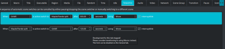

Ok, so I simply want to loop between two scenes but using macros this simply isn't working, a friend and I spent 3 hours banging our heads together and finally found a solution but it seems the solution is going away?( attached) how can I get this to work with macros? we tried Sequence macros but it stops and doesn't continue to loop. We're either both really dumb (likely) or macros aren't fully working yet for this kind of thing?
old_maple
It says development of this tab has stopped and switch to macro's but I can't get it to work for the life of me.
Using the tutorial that has everything in one macro with Waits in between, yes, that's true. Macros don't loop, so you have to explicitly re-trigger it every time if you go that route.
Use lots of macros! One for each step:
  • Step 1
    • Condition:
      • Scene _ for A seconds
    • Action:
      • Switch to Scene 1
  • Step 2
    • Condition:
      • Scene 1 for B seconds
    • Action:
      • Switch to Scene 2
  • Step 3
    • Condition:
      • Scene 2 for C seconds
    • Action:
      • Switch to Scene 3
  • Step _
    • Condition:
      • Scene [_-1] for ? seconds
    • Action:
      • Switch to Scene _
As you can see, I replaced the waits with condition timers, and each one creates the condition that the next one looks for. Then it becomes trivial to make it loop: just have the last one create the condition that the first one looks for.
And of course it doesn't have to be just scenes. It could be anything that Adv. SS can do.
Two huge advantages with this method, over the single macro with Waits, are:
  • You can enter at any point, just by making that condition true. In the case of a sequential scene switcher, just switch to any scene that's part of the sequence, and the macros take it from there.
  • You can escape just by making the conditions not true. In the case of a sequential scene switcher, switch to something that's not in the sequence before the timer runs out.
    • The single macro with Waits, from the tutorial, will continue to enforce the sequence until it's all the way done, even if you don't want it to anymore.

So the solution is not loop but make a shit ton of macros? that seems stupid since the sequence thing is in the list of macro's and it says that it will restart from the beginning once the end is reached so one would assume it would start macro 1 again go to macro2 and repeat? but it doesn't, seems broken to me.
I use that trick a LOT, by the way. Convert what's normally thought of as a single sequence, into a series of trivial actions that each have their own triggers. It works wonders in embedded programming too, where you only have one thread and a lot of things to do.
In the embedded world, it's literally one big loop that's always freewheeling, and inside that loop you have a bunch of conditional branches to do those trivial steps. None of those steps takes very long. No explicit delays or waiting for anything in any of them, ever, not even as part of a library. (which means that I increasingly have to rewrite or simply discard an otherwise good library function to make it non-blocking) Anything that might possibly delay the execution of something, is instead its own trigger for its own branch.
So you might imagine a dot that represents what the machine is currently looking at, constantly flying down the list of conditions over and over and over again, much faster than you can actually see it, and every once in a while, it branches off to do some part of something and comes right back to continue down the list. In the embedded world, all of that is explicit, but for us here, the main loop already exists, and we simply add our conditional branches to it.
Use the tools that are there, and make *that* sing. I've suspected for a while already that this plugin is Turing-Complete, which means that it's really a programming language that can do anything that any other Turing-Complete programming language can do, given enough time and machine resources. And I've seen some really stupidly inefficient "thought experiment" languages and machines, along with proof that they are also Turing-Complete. Compared to those, Adv. SS is not bad at all!
