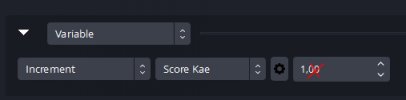

AlecsFR
Hi @Warmuptill !
Thank a lot for this very powerful plugin !
I have one question. Is it possible to increment a variable without decimal ?
I want, when My scene is play, increment a file .txt and add +1 not +1.00000
I try "Variable, Increment, var" but It's only with decimal.
Thanks !

This is the old Advanced Scene Switcher - I am using the latest version 1.20.2, which only has the General and Macro tabs.
No, it's the Macro tab, but for an old version that still showed them all by default. Macros still work the same way as shown there.
Are you storing numbers in the file as text? Otherwise, there's no difference.
That said, what it looks like you're doing is reading a file into a variable, incrementing that variable, and storing it back to the file. What happens if you just write the variable out, when it doesn't have a fractional value? Does it just write the integer part without the trailing zeros?
I think this is a case of understanding ALL of the possible uses. Some of us want to use fractional values. How should we do that? How should the system differentiate it? SHOULD the system differentiate it? If you understand mathematics, you'll know that 1.00000... = 1, so a potential problem really only exists when converting to text. Hence my question above.
(if you understand IEEE 754 floating point, you'll also know that not every integer can be stored exactly, but you have to get some pretty big numbers for that to happen...if it even *is* IEEE 754 under the hood; it might be something else)

Warmuptill
Hi @Warmuptill !
Thanks !
That is not possible at the moment.
I will add the option to round the variable values to the nearest integer to the todo list.
Thanks for the suggestion!
