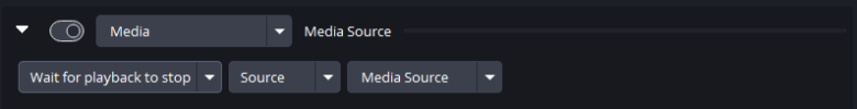

  • Added the option to wait for media playback to end to the "Media" action type.
    1730031967596-png.108800
    This should enable some users to simplify their macro setups.
