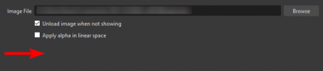

Outside of what I already suggested (e.g. setting a color for them or a name prefix) there is actually two ways, though I have to admit they're not obvious. One would be to click the plus sign to add a new source, select "Image (Async)", check "Add Existing" and then the list will show you which sources are async sources (or you do the same on the original image source). This will give you an overview at one glance.
Another one if you want to check it for a specific item just select it in the Sources list and check the area above the list on the right. The original image source will show the file path of the image there and a Browse button:
For the async image this area will be empty. This is actually something I didn't plan and only noticed now when looking for differences. One could see it as a missing feature, but now that I realized it can be used to quickly distinguish the two I think I'll just leave it that way.

BobbyJones

YorVeX
I asked about this specific section in the main window that displays a file path for the original image source and how I could show something there on the dev Discord channel, and the answer was:
So I guess this difference will stay and help to distinguish it from the original.
