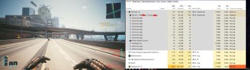

Heres what I understand (Correct me if I am wrong)
-Using NVENC makes it so OBS uses the dedicated video encoding chip on your Nvidia card. So far so good, 16-18% usage seems correct while using "GPU 0 Video encode". (First Picture) (Related to this, is it okay for OBS to use the 3D GPU? I imagine its necesary to render the preview correct?)

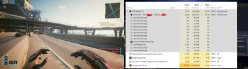

Then, for whatever reason, spikes to 25-30% and I cant figure out what causes it, I thought it was the browser source using up to 15% (Second Picture)

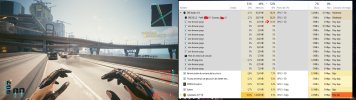

Hiding the browser source on the scene makes it stop using GPU, yet it still spikes to 25-30% on its own (Third Picture)

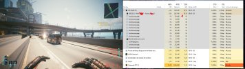

(ignore the amount of cars piling up in the game, even with that it kept going down to the original 16-18%
*Note: Since I took those screenshots I tried rebooting OBS and some of browser pages including "Host de ventana..." and "obs-ffmpeg" went away, in case you want to point the big amount of them, I was still left with 8 "browser page". Even with that its still the same issue, no change.
