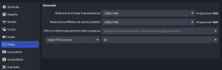

Jacon
Also some of my OBS setting rn
rockbottom
You need to reduce load, plain & simple. Run your monitor @ 60 or 120HZ. Reduce game quality, cap frame-rates, remove java script errors, ect.
