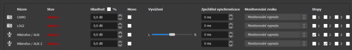

Hi,
in the end I just recorded through OBS, using MKV option with multitrack (FFMPEG), then I used VideoReDo for converting the video and getting both 24bit audio tracks into separated WAVE files.
I recorded at 48KHz as this is the highest rate supported by OBS. So I would like to ask - will OBS ever support 96kHz for recording?
Sincerely,
Richard Pohl
