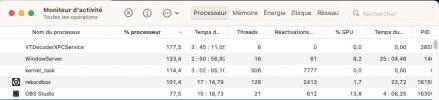

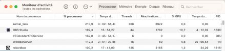

I am attaching 2 screenshots of the activity monitor before recording and during. VTDEcoderXPCService is really resource-consuming and when I start recording, OBS explodes and kernel_task starts increasing also.

Hey, you should probably be using the Apple H264 hardware encoder. Are you seeing high CPU in OBS stats? I doubt that you need a newer Mac to switch between a couple of scenes. Did you install OBS from the 'official' Mac package on the website?
