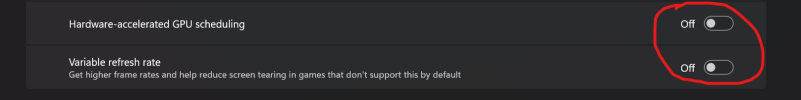

Hello, for me, disabling these two settings in Windows 11 worked.
Go to: Settings -> System -> Display -> Graphics -> Advanced graphics settings, and turn off these two settings: Hardware-accelerated GPU scheduling and Variable refresh rate
Also, you can try disabling them one by one.
This did it for me! Setting up a new Windows 11 computer after streaming on Windows 10 for so long and the freezing preview was driving me wild! Checked my GPU settings (Radeon) and Freesync was disabled, but VRR was turned on in Windows. Turned it off and that was that.
