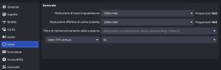

Changed some setting and try to run OBS and SM2 again, no issue, but it's only a recording, not a live, and only for few minute. (log below)
I leave some of my settings.

you have audio sources at different sampling rates (though webcam audio no in use, so maybe non-issue) ... best to fix at operating system level
chromakeying is computationally intensive... no surprise *if* system already fairly high that this alone could cause issues
And you've chosen settings (like downscale filter) which, if I recall correctly, and I could easily be wrong) is more CPU intensive

I have only the filter for the mic, like noise reduction (from nvidia broadcast) the compressor and the limiter. Also 2 filter for the webcam, a bit of color correction and sharpness.
My resolution is 1440p so it's better if I strem at 1440p and not at 1080!? Same at exit rescaling.
I've heard dawnscaling will be less "heavy" for OBS.
