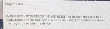

I recently switched to obs studio to try an fix the crashing issue I have been having. I only stream apex legends and I have no clue why I am crashing.
I use game capture for apex legends which is 1728x1080 and gets rescaled to 1280x720 and transformed to fit the 16:9 aspect.
Msi gaming x trio 3070
r7 5800x
4x8 3600mhz
6000bitrate
Nvenc h.264 encoder
rescale stream 1280x720
preset slow (good quality)
tuning high quality
Profile high
I really have no idea why it's crashing. I tried display capture today and was just gonna stream with black bars and it crashed immediately. There is no crash log that shows up. Does this mean apex is crashing when I stream and ob just crashes subsequently because apex crashed? regardless, this issue only occurs while streaming. I will post logs since that's the only info I have and the errors I am getting when it does crash. One of the errors is from apex when it crashes and the other is from obs when it crashes. keep in mind both are crashing not just apex and this only happens when I stream.

Oh, I had this before. Under Settings > Output (Advanced), change the Multipass mode to "Two Passes Full Resolution", seems half res breaks. This fixed it for me, haven't had that specific error in a bit

I will try this. My last option was uninstallling and reinstalling apex which I did when I posted this but I haven't had time to test it yet. I'll also change it to two passes full resolution next time I get on and stream and see if that fixes it. Thank you so much for the help. I'll reply if the issue persists after this and if it doesn't after a few days I'll also come back and let you know. Thanks again!
