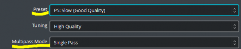

I want to ask about these two settings:
- Preset
- Multipass mode
I use NVENC and Preset P5: Slow (Good Quality) and for Multipass I use Single Pass.
What are the correct settings for streaming? Is there anything we should be guided by when choosing these options?
Is it a big diference betwenn P5 Slow Good Quality and P7 Slowest Best Quality when it comes to computer load (usage) during the stream?
