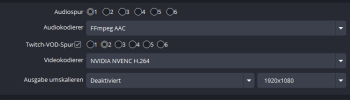

Here are my current settings https://imgur.com/a/6JWZTYT (Screenshots from my Settings all in one) :
  • Base (Canvas) Resolution: 2560x1440
  • Output (Scaled) Resolution: 1920x1080
  • FPS: 60
  • Encoder: NVENC H.264
  • Rate Control: CBR, 8000kbps
  • Keyframe Interval: 2s
  • Preset: P7
  • Profile: High
  • B-frames: 2
  • Lookahead: ON
  • Adaptive Quantization: ON
  • Custom options: aq-strength=15 psy=1 psy-rd=1.0
My PC should be powerful enough (RTX 3080, Ryzen 5900X, 32GB RAM), and I don’t get in-game FPS drops or encoder overload warnings. The problem is really just that the stream looks awful when moving fast compared to others.
Has anyone experienced this with DBD specifically? Are my settings fine, or is there something I’ve overlooked that could help reduce this extreme pixelation?
Thanks a lot in advance – any advice or comparisons with your own settings would be super appreciated
Im Clueless an out of ideas. Anybody sees anything that i cant see? PLEASE...

VitorNS94
Encoding time can cause pixelation on fast frame change, like high movement content.
That's why sometimes is better using a lower preset, to reduce encoding time.
P7 is the worst on encoding time.
