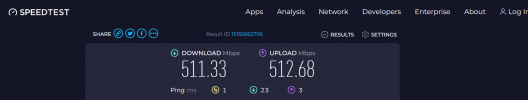

Just the usual speed test. I tried to find some long upload tests websites but I couldn't. You know a good one?

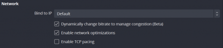

AV1 may not support Dynamic Bitrate. When AV1 is selected as the Video Encoder for Streaming, go to Settings, Advanced, Network. If Dynamic Bitrate is available and enabled, it should look like this:
If that is not available, then AV1 doesn't support it. You'll either need to lower your bitrate to the point where you're not dropping frames or use HVEC or H.264.

Yeah, I did select "av1" AND "Dynamically change" as you can see in this screenshot. But frame drop still happen

qhobbes
When Dynamic Bitrate is enabled and working, it should show it in the logs such as:
14:59:52.954: [rtmp stream: 'adv_stream'] Dynamic bitrate enabled. Dropped frames begone!
Your log does not show that. Try using HVEC or H.264 with Dynamic Bitrate.
grepolis
Ooooh yes, you are right. I just tested and yes I can confirm that AV1 and HVEC still don't work with "Dynamically". I was only able to actually use it with H.264
